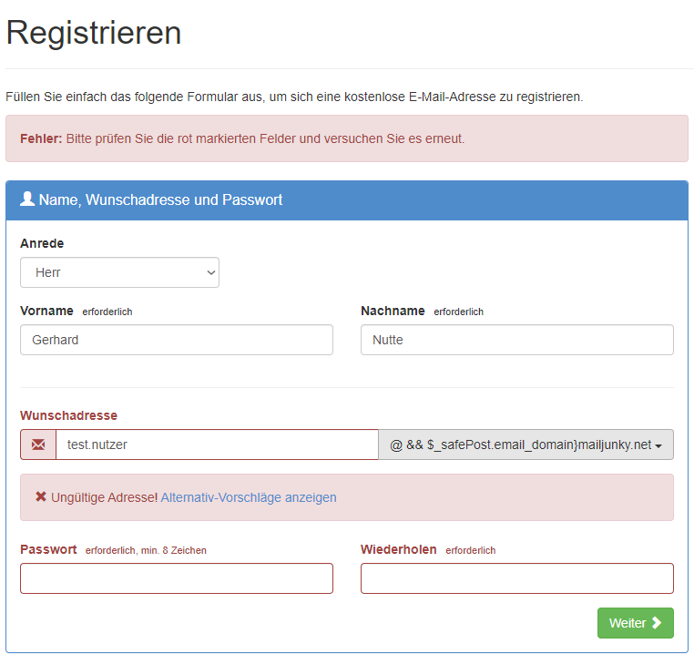

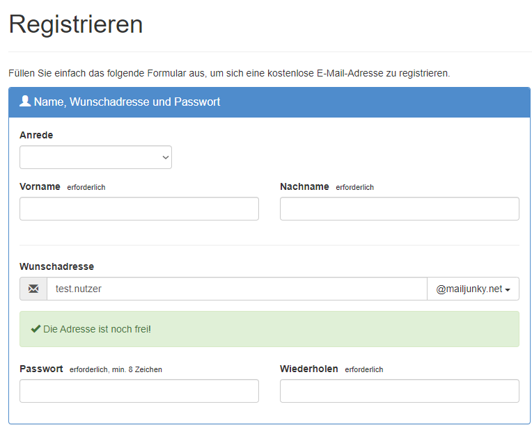

Beim Registrieren hab ich folgendes Problem
image.pngIm ersten Moment sagt er alles ist okay, nach eingabe allter daten wird mir gesagt dass die Wunschadresse nicht mehr frei ist.
Beim 2ten mal klicken auf "Abschicken" kommt dieserWas mache ich falsch? Stimmt was mit meiner nGinx Config nicht?
Codeerror:0A000086:SSL routines::certificate verify failed in /var/www/html/www.mailjunky.net/serverlib/http.class.php on line 104PHP message: PHP Warning: stream_socket_client(): Failed to enable crypto in /var/www/html/www.mailjunky.net/serverlib/http.class.php on line 104PHP message: PHP Warning: stream_socket_client(): unable to connect to ssl://www.google.com:443 (Unknown error) in /var/www/html/www.mailjunky.net/serverlib/http.class.php on line 104PHP message: PHP Warning: fwrite() expects parameter 1 to be resource, bool given in /var/www/html/www.mailjunky.net/serverlib/http.class.php on line 181PHP message: PHP Warning: fwrite() expects parameter 1 to be resource, bool given in /var/www/html/www.mailjunky.net/serverlib/http.class.php on line 182PHP message: PHP Warning: fclose() expects parameter 1 to be resource, bool given in /var/www/html/www.mailjunky.net/serverlib/http.class.php on line 186" while reading response header from upstream, client: 10.50.2.27, server: www.mailjunky.net, request: "POST /index.php?action=signup HTTP/1.1", upstream: "fastcgi://unix:/var/run/php/php7.4-fpm.sock:", host: "www.mailjunky.net", referrer: "https://www.mailjunky.net/index.php?action=signup" 2024/06/01 16:13:57 [error] 512#512: *1355 FastCGI sent in stderr: "PHP message: PHP Warning: stream_socket_client(): SSL operation failed with code 1. OpenSSL Error messages: error:0A000086:SSL routines::certificate verify failed in /var/www/html/www.mailjunky.net/serverlib/http.class.php on line 104PHP message: PHP Warning: stream_socket_client(): Failed to enable crypto in /var/www/html/www.mailjunky.net/serverlib/http.class.php on line 104PHP message: PHP Warning: stream_socket_client(): unable to connect to ssl://www.google.com:443 (Unknown error) in /var/www/html/www.mailjunky.net/serverlib/http.class.php on line 104PHP message: PHP Warning: fwrite() expects parameter 1 to be resource, bool given in /var/www/html/www.mailjunky.net/serverlib/http.class.php on line 181PHP message: PHP Warning: fwrite() expects parameter 1 to be resource, bool given in /var/www/html/www.mailjunky.net/serverlib/http.class.php on line 182PHP message: PHP Warning: fclose() expects parameter 1 to be resource, bool given in /var/www/html/www.mailjunky.net/serverlib/http.class.php on line 186" while reading response header from upstream, client: 10.50.2.27, server: www.mailjunky.net, request: "POST /index.php?action=signup HTTP/1.1", upstream: "fastcgi://unix:/var/run/php/php7.4-fpm.sock:", host: "www.mailjunky.net", referrer: "https://www.mailjunky.net/index.php?action=signup" -
